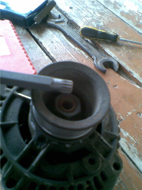

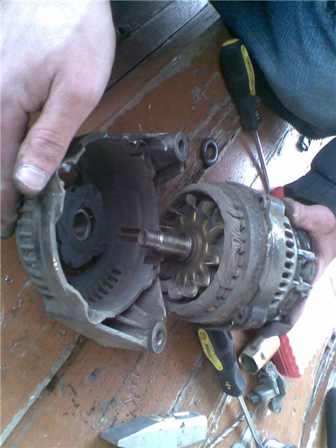

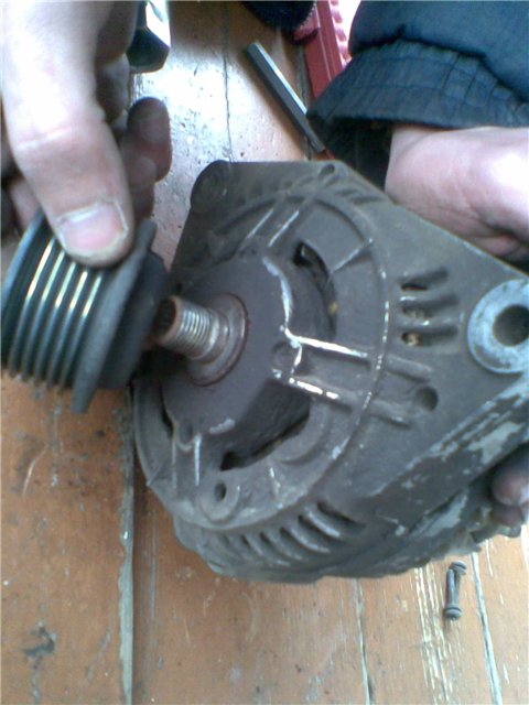

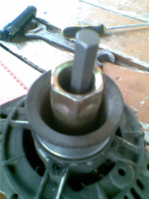

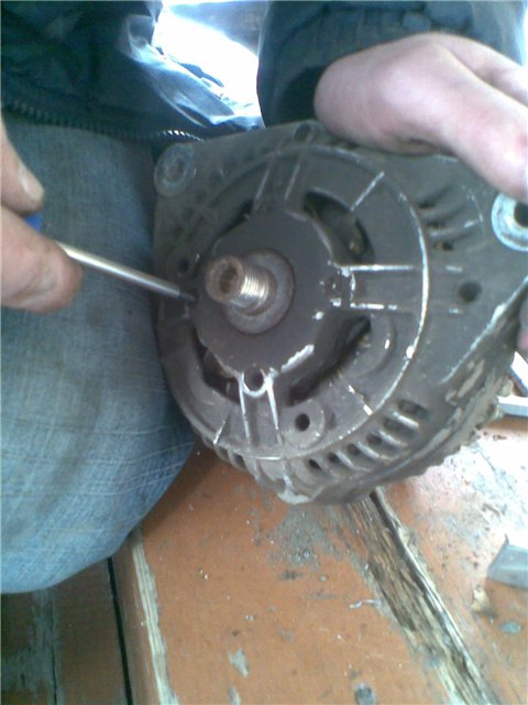

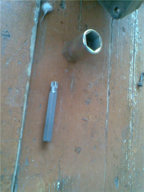

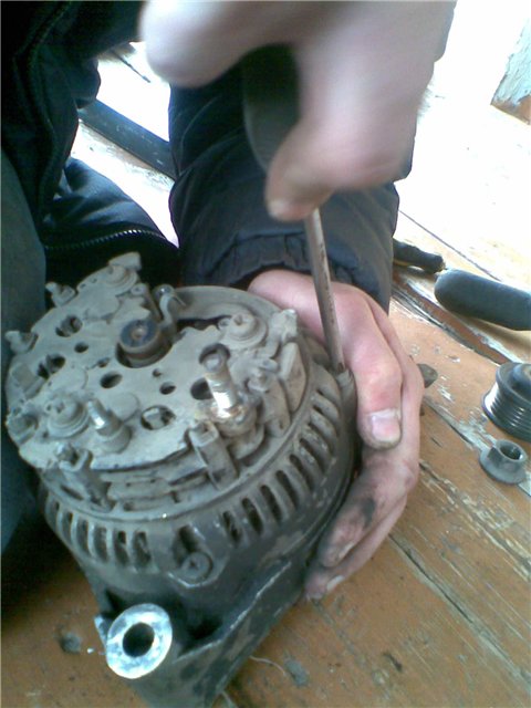

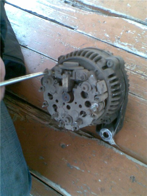

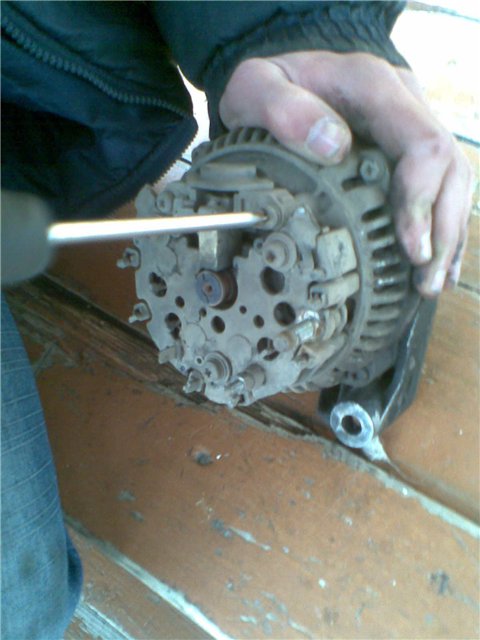

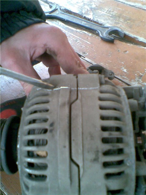

Замена переднего подшипника в генераторе БОШ.
https://w202club.su/radikal/000/F/s54.radikal.ru/i145/1107/96/5936d841b1a5.jpg" rel="nofollow" target="_blank">https://w202club.su/radikal/s54/i145/1107/96/5936d841b1a5.jpg" alt="https://w202club.su/radikal/s54/i145/1107/96/5936d841b1a5.jpg" />
https://w202club.su/radikal/000/F/s002.radikal.ru/i200/1107/a5/b9b0376c9f0f.jpg" rel="nofollow" target="_blank">https://w202club.su/radikal/s002/i200/1107/a5/b9b0376c9f0f.jpg" alt="https://w202club.su/radikal/s002/i200/1107/a5/b9b0376c9f0f.jpg" />
https://w202club.su/radikal/000/F/s014.radikal.ru/i327/1107/43/b7bf18539586.jpg" rel="nofollow" target="_blank">https://w202club.su/radikal/s014/i327/1107/43/b7bf18539586.jpg" alt="https://w202club.su/radikal/s014/i327/1107/43/b7bf18539586.jpg" />
https://w202club.su/radikal/000/F/s57.radikal.ru/i155/1107/3e/71e5b158f61d.jpg" rel="nofollow" target="_blank">https://w202club.su/radikal/s57/i155/1107/3e/71e5b158f61d.jpg" alt="https://w202club.su/radikal/s57/i155/1107/3e/71e5b158f61d.jpg" />
https://w202club.su/radikal/000/F/s46.radikal.ru/i111/1107/47/a85fd6b0e48a.jpg" rel="nofollow" target="_blank">https://w202club.su/radikal/s46/i111/1107/47/a85fd6b0e48a.jpg" alt="https://w202club.su/radikal/s46/i111/1107/47/a85fd6b0e48a.jpg" />
https://w202club.su/radikal/000/F/s53.radikal.ru/i142/1107/6b/8cdd5dc2d225.jpg" rel="nofollow" target="_blank">https://w202club.su/radikal/s53/i142/1107/6b/8cdd5dc2d225.jpg" alt="https://w202club.su/radikal/s53/i142/1107/6b/8cdd5dc2d225.jpg" />

Думаю описывать не надо по фоткам все понятно.
